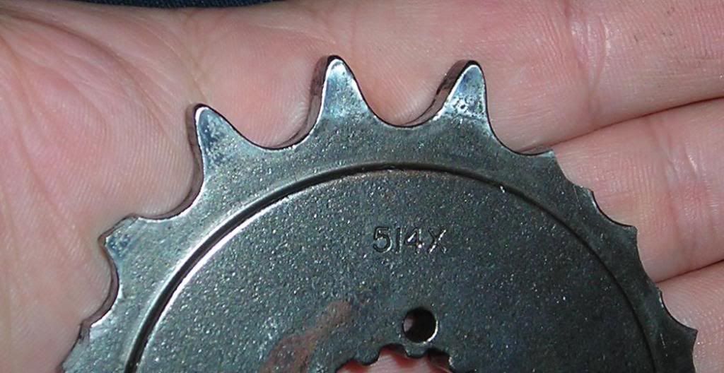

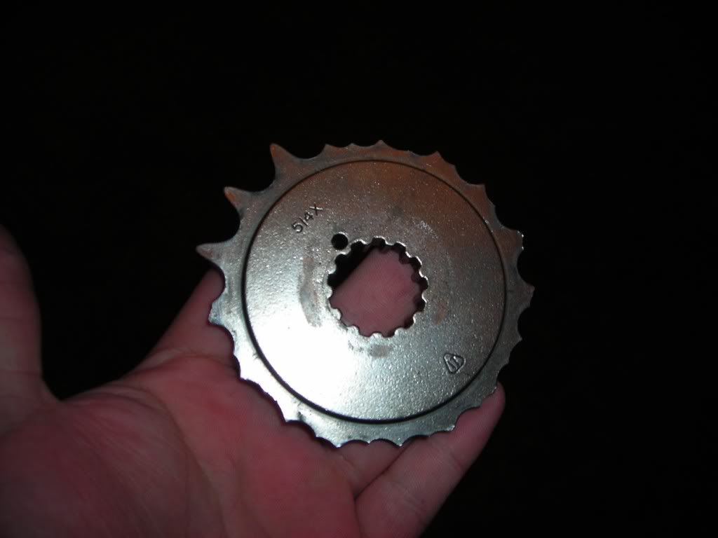

Idk what happened. The rear sprocket is fine, I'll take it off in a few mins and snap some pics. The teeth came off over the last 1000 miles or so cuz thats how long its been on the 1000. It was on my 06 750 before that and I installed it the same way as I did on the 750.
Heres the pics. Sorry for the blurry one, I was a lil too close it
This shows how it was mounted, even though its blurry you can still see that theres a lip on this side. The other side is smooth with no lip.

damn you destroyed that sprocket. Maybe the rockwell was to hard and the teeth snapped due to the burnout? id be checking to see if maybe your alignment was off causing your chain to start skipping teeth
#20 ·
Wow, those are some crazy ass pictures. Never saw anything like that on a bike. Even nitro hillclimb bikes that caught a rock in the chain didn't blow teeth off like that. Keep us posted what the mfg says, I'm really curious what the hell would do that.

I've talked to a few manufacturers and none have seen something like that happen. Maybe if the front sprocket wasn't heat treated and it slipped by or something, but it's very weird that alum teeth would be fine and even the chain but yet THAT many steel teeth are gone.
Add those teeth up and a high powered rifle can't shoot through that much steel. In fact there is so much steel there that the chain should have snapped way before that based on how much force it should have taken to do that.
this isn't about "wearing" out, but something massive and catastrophic happening. The cause is the key and not being heat treated is a possibility, but to be honest you have every other manufacturer scratching their head as well as they haven't seen it either.
Post up what Sprocket Specialists says about this. This is very weird.

after seeing everything, i am guessing it was a manufacturer's defect.
if the front sprocket was torqued properly, and red loctite was used, and no teeth were sheared off the rear sprocket, and the rear sprocket doesn't show signs of extreme mis-alignment, i am guessing defect.

Never saw a front sprocket look like that. I think Mummy's right. Somehow that sprocket got skipped in the heat treatment process.
