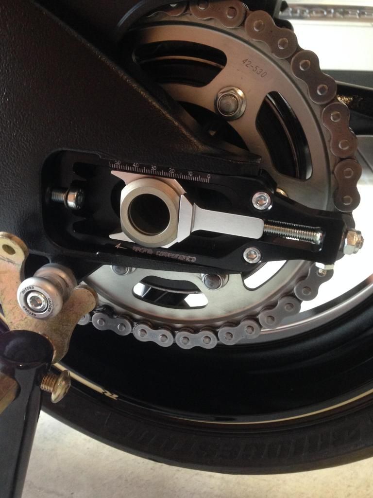

Thanks for sharing. The dealer went ahead and swapped in the Yoshi blocks and the bike feels solid now. The parts have been sent off to Suzuki for testing and i'll report back on their findings.

#24 ·
beware i had a set of those brake on a customer bike the bolt snapped... axle then slammed forward and chain jumped braking the case. i had a set on mine i then removed and installed a set of yosh blocks i wont sell them anymore.
jason
#26 ·
Cheers for the heads up, have used before on other bikes with no issues & have not heard of any issues before. I will look into making a "fail safe" mod though.
