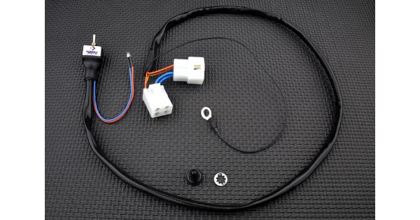

The paperclip will require that you either leave it in dealer mode, not a good idea if doing so causes the temp display to be obscured, or shut it down to take the seat off to connect the paperclip. A real dealer mode switch doesn't cost that much and, if properly routed, will allow you to turn it on & off without turning the ignition off, etc. Many FI codes are cleared when the ignition is turned off.
#7 ·
smart moto
radiator fan bypass on off switch
Dealer mode
