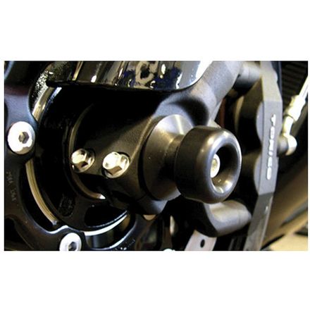

Hi team,
I got a new 2022 GSXR-1000R and the wheel sensor is right where I normally put the front stand (see picture). Have you guys got this problem? Do you just undo the sensor to move it a little then put the front stand in the normal spot? I've not used this type of front stand before is that the right spot for it?

I have a 2018 1000R and I use an Oxford front stand with a similar design. I just cut the lug closest to the sensor down in length so it doesn’t interfere with the sensor but still supports the fork leg.
This way I won’t accidentally damage the sensor when I’m not paying attention.

Yeah it barely makes it. I didn’t think I could take the wheel off either so I used the pin stand instead. I suppose if you cut the shift side of the pitbull stand it would clear it enough to take the wheel off. Or take the sensor off each time.
