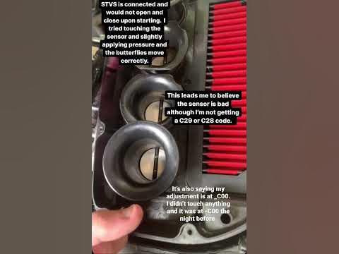

I opened the airbox up and noticed the butterflies would not open all the way upon turning on the bike. (not starting it)
It would move down a bit and stay that way. I tried touching the sensor with my finger and applied a little pressure or moved it around and it suddenly opened and closed as its supposed to. Note the bike is in dealer mode.
I have a short on youtube I made to better describe what I'm talking about.
I really think it's my sensor that needs to be replaced but want to hear other's opinions before I did so. Let me know, thanks!

On one of the service records I received from the previous owner I remember seeing one for adjustment of throttle bodies to sync correctly or something I don’t remember as I don’t have it in front of me but that was a couple thousand miles ago. Could that have gone out of adjustment somehow?
when I disconnect the plug for the STVS the valves/butterflies move as they’re supposed to, open and closed. But when connected they do what’s on the video.
I’m Also when putting things back together the bike won’t idle on its own until it’s at temp otherwise it’ll stall. Didn’t do that before I messed around, maybe there’s an air leak?
Also in the video I press on the sensor and it moves the valves correctly.
regardless I think the air/fuel ratio is separate from the sensor as you said. It’s backfiring like crazy and I’m not sure why. The only other code I get is C46 because the cat was deleted and it straight piped with a shorty gp tip.

You sure it's my actuator? I get no code whatsoever and if I disconnect the STVS, the actuator moves the throttle bodies correctly as it's supposed to. When connected it stutters closed instead of opening and closing like when it's disconnected. If I force them open the C29 code comes up but it corrects itself. Also with no screw adjustments, the -C00 goes to _C00.. so I'm thinking sensor.

Well to conclude this thread, I have officially solved my problem.
Thanks to all who contributed by replying and giving their insight.
@Cole777 As I suspected, it was not the STVA still being faulty, it was the STVS. I replaced the sensor and installed according to the manual and @TheGeek 's instructions on a different post.
Full power back baby. Feels good to be back after a month of this bs.. ride safe!
