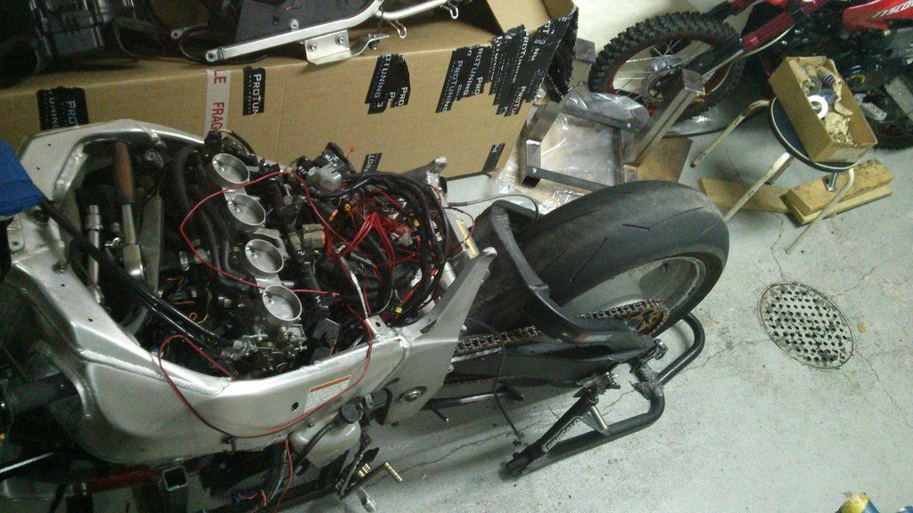

I found a good deal on a K5 1000 frame with a title so I decided to upgrade my old K1 "750".
Frame didn't have the recall done, so that was the first thing to do.
A month later.
The engine was fully rebuilt two years ago when I did a 1K engine swap and we did some performance mods.
Modified pistons, we used K7-K8 1000 pistons because they are supposed to be stronger than K5-K6 1000 pistons. Decked head and block (total 1.22mm) to raise comp to ~14:1, K7-K8 1000 cams + APE gears, Yoshimura valve cotters and APE ti retainers. Also the normal upgrades like APE MCCT, Akrapovic full system and Factory pro shift star.
I used K8 1000 electronics system because K8 ECU is fully compatible with EcuEditor and WRT software. IAP/TPS fuel maps and IGN map are custom mapped on a dyno and I have made some fine tuning using Woolich Logbox.
Front forks are K9 1000 with Andreani cartridge kit and rear shock is revalved SU-149 Öhlins to suit linear linkage, longer swingarm and 1K's power.
My friend's stock -15 S1000RR, my bike and someone's K5 1000 with a full system and custom map.
I'll use some of the old parts like Spondon swingarm, suspension, rearsets and lights.

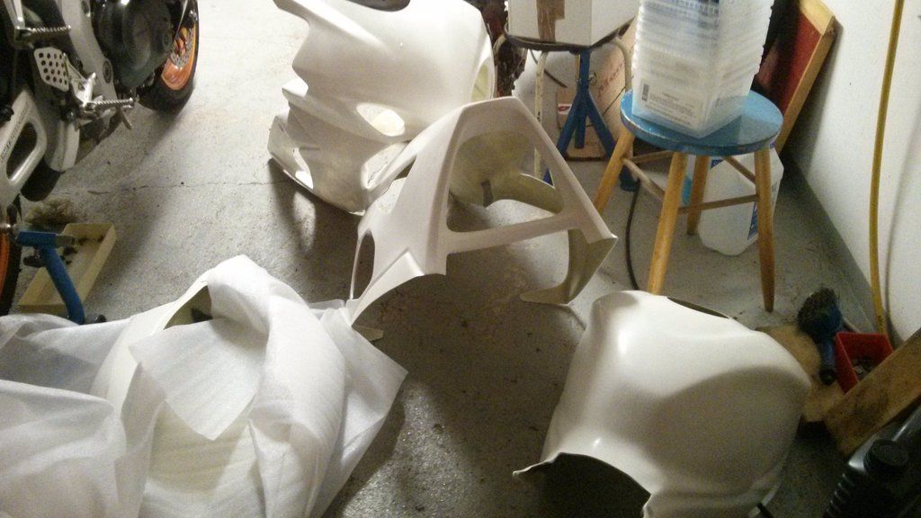

A set of race fairings with a K7 tail because it looks better than a K5 tail. :)

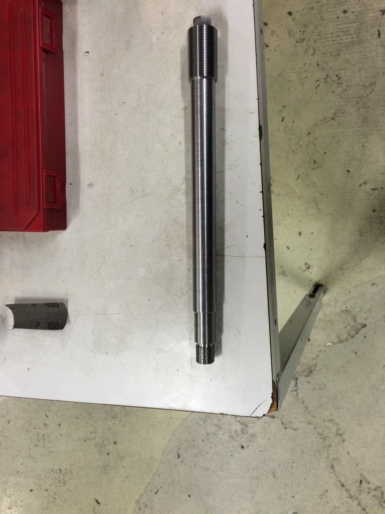

A new swingarm pivot axle
