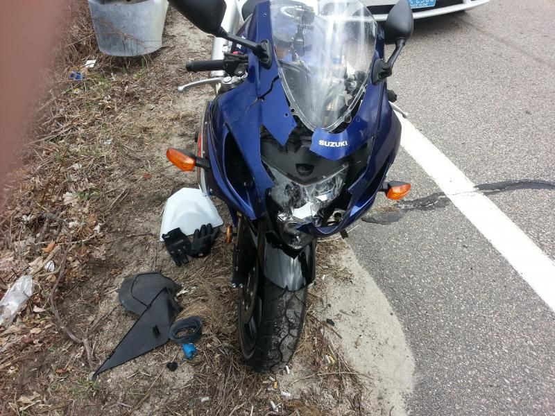

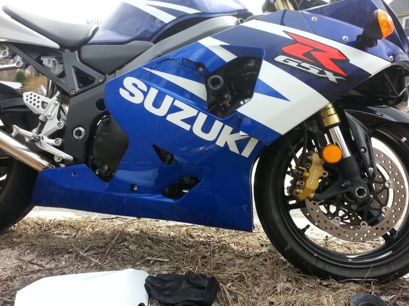

The Damage
From what I can tell after investigating the broken pieces, it looks like brunt of the damage was caused by the failure of the front fairing stay. When that failed, the front fairing, headlight assembly, and instrument cluster were free to fall away from the bike and become damage.
The right side fairing cracked under the stress of the entire front fairing assembly losing support from the fairing stay. I had frame sliders on the bike, so the fairings had no scratches at all, although the stator cover got scraped a bit.
Power was still being delivered when the ignition key was turned on, indicating the wiring harness and battery were undamaged (signals & horn still worked). Unfortunately, the kill switch must have developed a loose connection so I was unable to start it.

Glad youre alright. The bike is definitely fixable. I wouldnt even worry about the side fairings!
