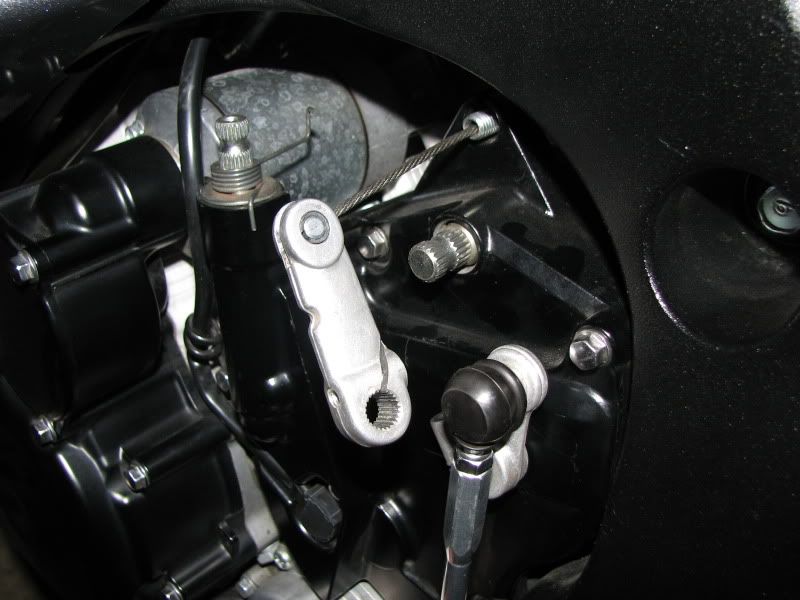

Switch the shift lever to the other side like so:
Depending on where the pedal is positioned, the rod may hit the water pump housing:
To fix this, we need to reposition the pedal. Remove the snap ring, circled in red, in the above picture, then you are left with this:
Remove the pivot with a deep 14mm, then install it in another hole. I also used a little grease and applied it to the pivot to ensure proper operation. Reinstalled the snap ring and re-check clearance from the water pump:
Here is how it looks with the reversed shift pattern:
