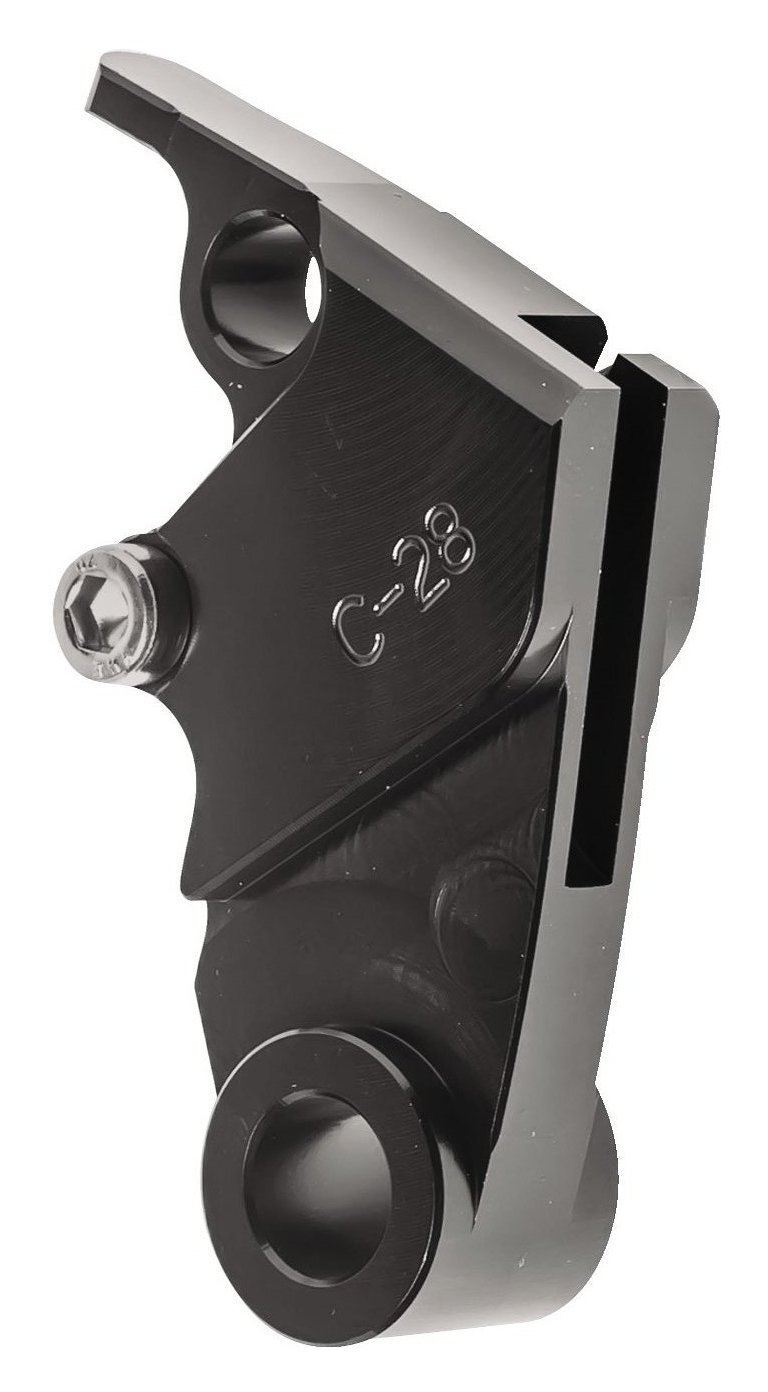

The new clutch lever is a Puig foldable 3.0
I've got it pulled back to show you how much slack there is (not much).
And I've got the adjustable-reach set to the #1 (or is it #6) point where the lever is furthest from the grip.
Automotive tire Motor vehicle Automotive design Rim Bicycle part
The Puig is comprised of a mount and a lever, two separate components.

The fine tuning is done by the knurled nob by the lever. That's the last thing to adjust though. Usually I set the knob in the middle and set everything else so the clutch is fully functional then I use that to fine tune where is grabs and the amount of slack. I end up with about an 1\8th inch slack.
The puig lever is probably adding a level of confusion to your adjustments. It's really only used to set the distance of the lever to your bar. By itself it doesn't effect the clutch action except for your perceived engagement points. I would probably toss the stock one back on just to make things a bit easier then put the puig back on or set it to a middle position and leave it.
