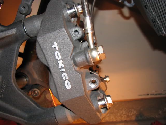

Now remove the pads by unscrewing the 5mm hex bolts, NOT the torx. In the picture below, the bottom one is removed, the upper one is still in.
