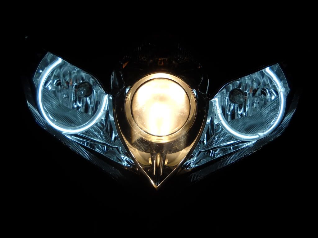

Searched the forums and looks like theres nothing too much on installing halos on our year bikes. Knocked out the job today on my new stallion.
this picture ^^^ came out all blue on the highbeam sides. It does look pretty badass though because the lowbeam is like a warm 4000k while the Angel eyes are a nice bright 5500k white. Ill get better pics because the halos are only hooked up to a power supply. I haven't wired a switch and fuse yet, which is coming tomorrow.

I have no clue how you would use leds as turn signals but whatever. These were big as hell, almost too big, I can't remember but i had to shave off the 3 other mounting tabs because they stuck out. Looks just how i wanted it tho

I could only take that when i had the power supply feeding it voltage not the bike. It was disassembled and ugly. I just spent 3 hours getting the bike clean and shiny tonite so tomorrow I will post more pics. I Personally like the contrasting colors between the lights, it makes the eyes stand out more.

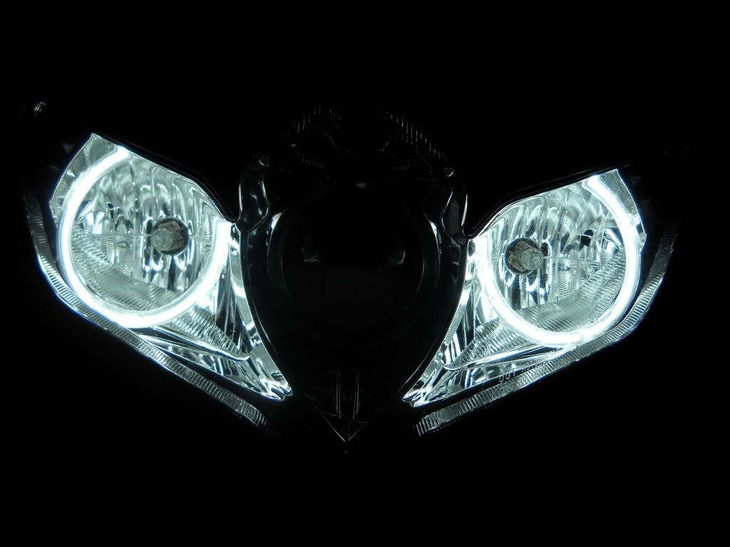

Ill get some more pics as well. The black looks retarded Nice with the white halo's. I wanted to stay with white to keep the colors neutral, so i wouldn't have to add more of the color of the halo to the bike to match.
