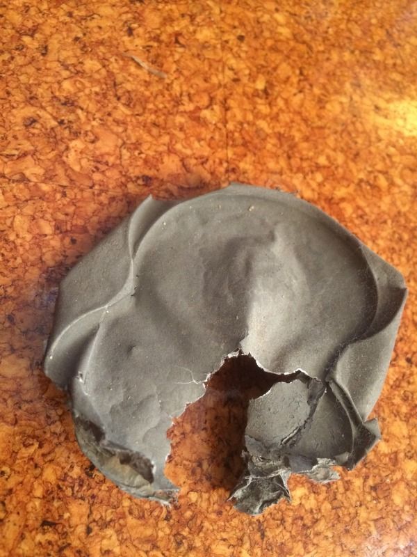

What impressed me most was after our fires a couple of yrs ago, my spare race motor was in a wooden floor and wall storage shed with a lot of other flammable stuff like tires, fuel,etc, motor completely gone, hot enough to melt the copper head gasket (just over 1000C) and be left with a pile of valves, inserts, head studs bolts etc and in all that was the ceramic piston tops
here is one i saved
