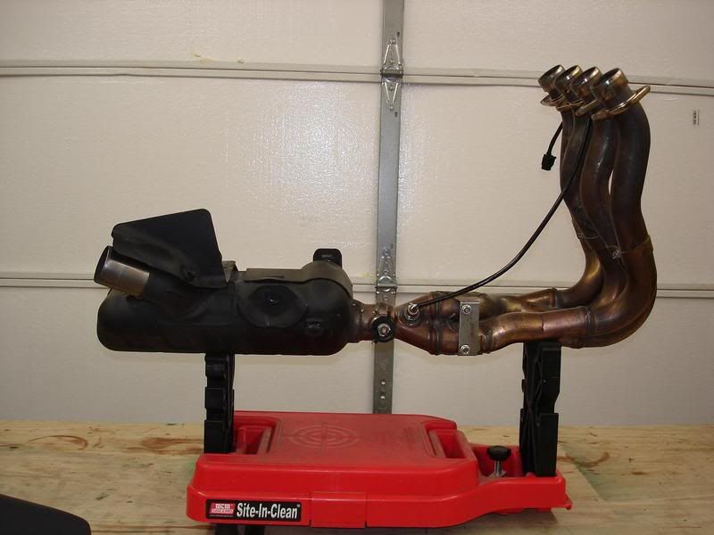

Here is your stock exhaust system (All 22 lbs of it..)
This is why we HATE it. (CAT is welded to the midpipe/header)

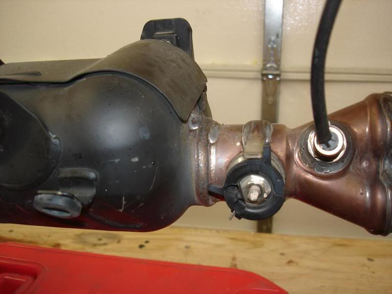

This is what is left if you want to simply want to install a stock 08 slip on. (With previous year models the cat came off with the stock muffler when you installed a slip on.)

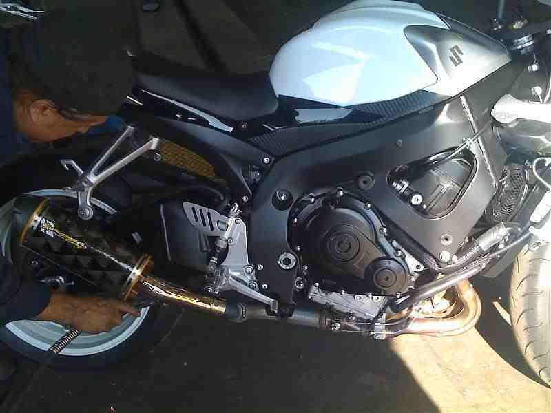

1. Buy a stock 08 slip on. This does not eliminate the cat and isn’t the most eye appealing. You get better sound and looks than stock but you still retain the heavy/ugly cat. (Pick courtesy of Freekobe15)

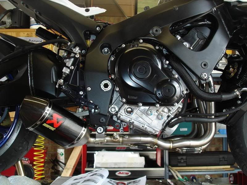

3. Buy a stock 08 slip on, cut the cat off and fabricate a midpipe to fit in the space between the muffler and SET Valve. Any muffler shop could probably do this. This is the best option if you have already bought a stock 08 slip on and want to eliminate the cat. (Pick courtesy of Freekobe15)

That is my bike in option #3, and I HIGHLY SUGGEST to get a custom map done witha pcIII. I also removed my set valve as well. I put a full exhaust system map on my PCIII and there is a big of a lagg getting out of first gear... I am going to get a custom map and dynoed this week... hopefully it fixes the problem as the shop told me that it would def. fix the lag... Anyone have suggestions as to why i have the lagg? Im guessing the custom map will fix it... I'll let you guys know how it feels after the custom map...
Other than the lagg the bike IS 100X louder than before and along with the PCIII it rides wayyy better and can feel the dif. in power... I also somewhat de-stickered my bike... what do you think? take em' all of or leave it the way it is??
