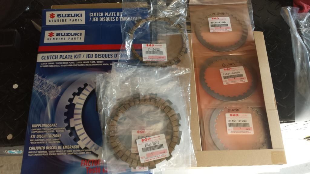

It came with:
1 x 21442-41G00 fiber plate, which measures 0.112" (which is 2.84mm) according to my Dillon calipers
9 x 21441-36F10 fiber plates, one of which measures 0.112" (didn't measure the others)
1 x 21451-41G10 steel plate, which measures 0.078"
1 x 21451-41G20 steel plate, which measures 0.101"
9 x 21451-41G00 steel plates, one of which measures 0.090"
If the install goes anything other than totally normally, I will definitely report back with an update.
How about the thicknesses of the steel plates?
6
I updated my previous post. Here are some pics or it didn't happen.
