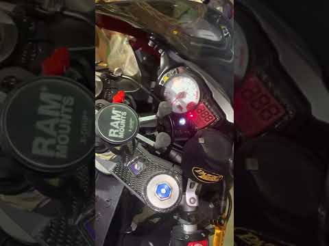

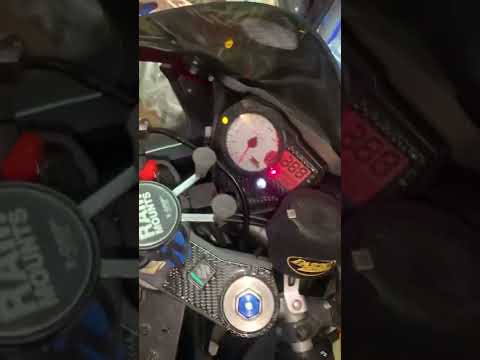

I replaced my stock cam chain tensioner adjuster with an APE manual one to try to fix the ticking noise my k6 750 was making.
I replaced it…. But unfortunately now my bike won’t start.
Here’s vidshowing what happens when I try to start it now:
I will recheck wiring visually again andsee if I can find something wrong.
Anyone have any idea what might be causing this?

I did zip tie the chain to the sprockets, however I didn’t line up the timing marks to begin with. The ticking noise is coming from the fuel pump relay and there is more noise coming from deeper, sounded like the throttle body. I don’t think it’s possible I bent valves throughout the process because I didn’t touch them and the bike hasn’t started up since I changed the CCT. Unless, the valves were the original problem and it somehow got worse by changing the CCT?

No fuel pump prime, throttle body cycling, ECM flashing warning.
Yup, seems accurate.
