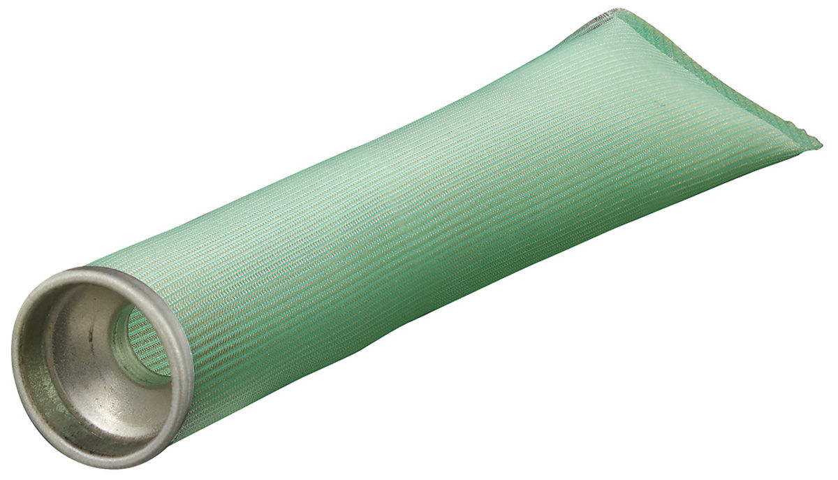

When I think of sock, I'm referring to something like this:
It's akin to the strainer at the bottom of your pump. The main/real filter has a much finer rating.
