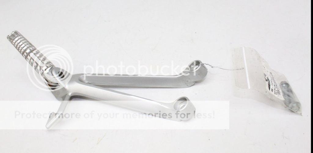

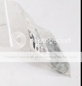

did not see this picture yesterday, the bolts I received are MUCH longer and do not thread the entire length.
here is the OEM pegs I bought
notice the bolts
fastfedd is offline

Yeah, those are some random bolts.

I saw the ebay listing last night and was wondering about it, namely I thought that the bolts had a button head. So I dug up a pic this morning and added it to my post, hoping that you'd see it. Hard to tell but your's look more like this:
Wrong head, too long.

that's mine!!
This ebay seller is awesome too! he has all OEM items (used but in good shape) for decent prices, best part his shipping is extremely fast.
Shame but I think I'm going to have to let him know about this.
Bill, those are the bolts it came with, it might have just come off of a bike and he packaged it up thinking it was oem.
thanks

That bolt is associated with an exhaust clamp and with attaching the cowling brace to the front of the frame.

So there should only be 1 of those bolts and 3 like you showed?
I saw the exhaust hanger, but that was on the right side of the bike, the issue was the left side.

The first button head bolt that I showed is used in eight places, four for the front footrests and four for the rear footrests. The second hex flanged bolt is used in three places, two at the cowling brace and one at the exhaust clamp. However things are slightly more complicated. The OEM flanged bolt was 01550-08403 and had an olive drab finish. It's been superseded by 01550-0840A and 01550-0840B, which I think both had the zinc plated silver finish in the picture.

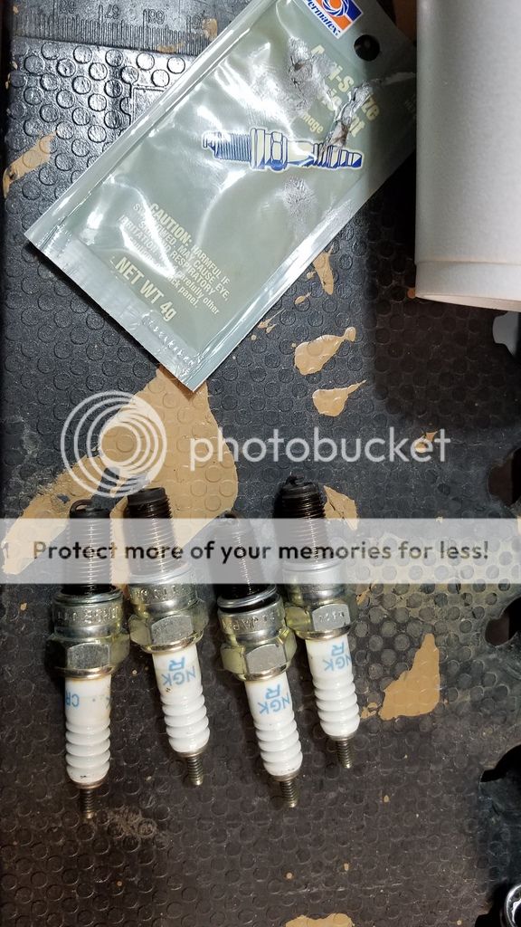

I changed the plugs while I was at it, they looked a little dark
Put it all back together and got proper 23mm bolts. Bike is running great, although I need to some how clean those valves, not sure if time will eventually do it or maybe some seafoam?
