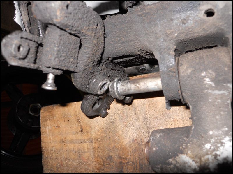

This is from another thread here and shows what things can get to:
Rather than fool with the kickstand bolts, he cut the front linkage bolt in half to get it out.
