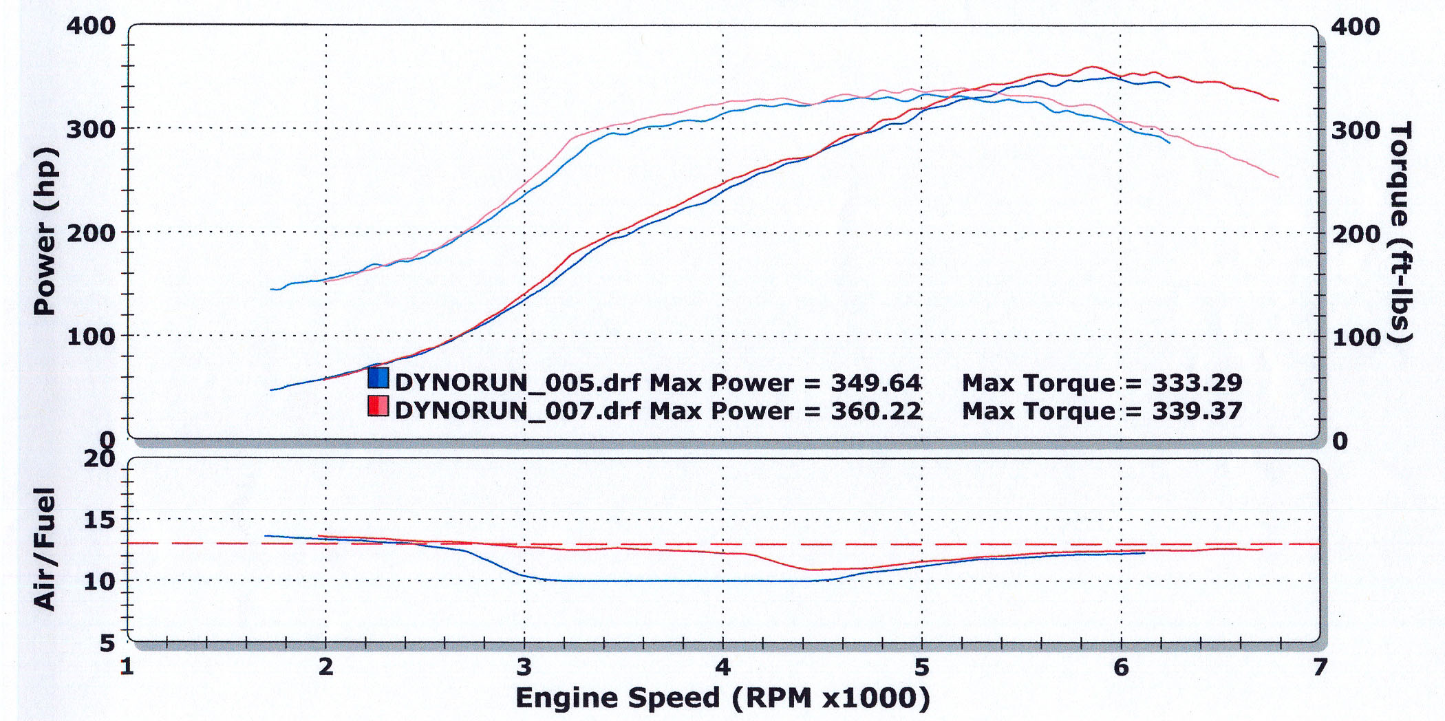

How's my Dyno chart look?
This is my first time getting a dynotune. Bike seems to perform better now. Is this the kind of results I should expect from my mods? Or can I get a better line?

it looks like your "tuner" did 3 runs and tuned for max power. you paid $150?

Should have at least flattened that dip between 3-5k rpm

What happened to the air/fuel ratio????

Mac: I paid $200...kinda glad he tuned for max power...I can always change to old map to save gas right?
trackday: I agree about that dip...wtf
2007: not sure what you mean??
Well, it depends, how much time do you typically spend in the 13-15,000rpm range.
If this is a racebike I would imagine more often, if its a streetbike I'd guess hardly ever right?

The last run looks really good for a slip on. What the hell was wrong with the first two runs?

I'm wondering what exactly was done between the 3 runs to gain over 36 HP.
+2 where's the afr log?

Uhhh....from what I understand the reason the first two runs are lower is because they were making modifications to the map through the process. and gaining power each time.
hey when you say air/fuel ratio...Im not really sure what you mean? The map? like the fuel table you can see in Power Commander software...? or...?
They also took out the baffler in my M4 slipon....Im gonna put it back in though because it backfires. Is that something they should have "tuned" in the process? the backfire? It doesnt backfire with baffler in

baffle won't cause it to backfire or not backfire. It's only there for sound control. If you're popping or backfiring, try plugging the pair valve. You're just getting to much air in the mix and blocking that should prevent it from happening.

In order to make modifications to the map they stick a probe into the exhaust to measure the air/fuel ratio in the exhaust gasses. This tells them if the bike is running lean or rich throughout the rev range and different throttle positions.
Usually a dyno printout will include the a/f ratio tracked along a line on the graph as well.

I'm thinking they were adjusting the dyno to show you the bike was making more HP each run. You bike stock makes better than 96 hp at the rear wheel. I hate to say this but I think they sold you some snake oil . Not to burst your bubble but the mods you have aren't really going to gain you that much HP over stock. You may have realistically gained 3 or 4 hp .

Coopgt...damn that sux...but dude only told me I gained about 6 hp which I thought was kind of high...only expected a few like you said....I really wasnt only looking for hp just wanted that custom map.

I dont know why they didnt give me air/fuel....this was my first time so I didnt know to ask....live and learn
