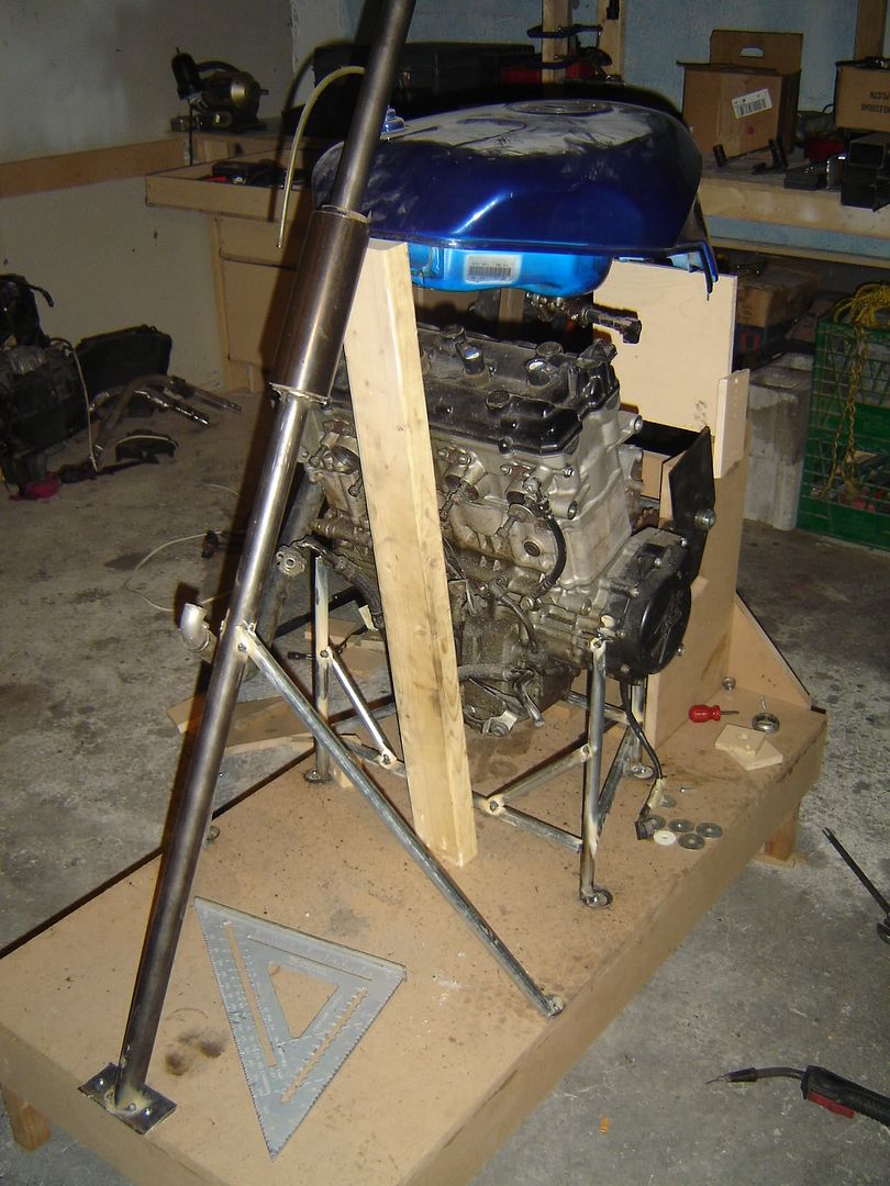

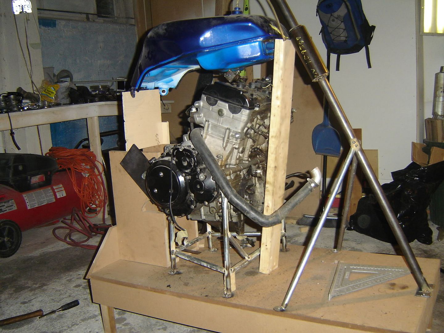

I had another thread but it was a all over the place. I am at the point of starting a scratch build tubular frame. Got all my hardware machined out and ready to start bending some tube. Im keeping the tank, front end, rear sets, and more than likely the original bodywork with a nice OEM scheme. Make it a sleeper. Here are some pics of the beginning stages with neckstock on and swing arm pivot bolts in place. And the motor is square and plumb to the swingarm and neckstock.
[IMG][/IMG]

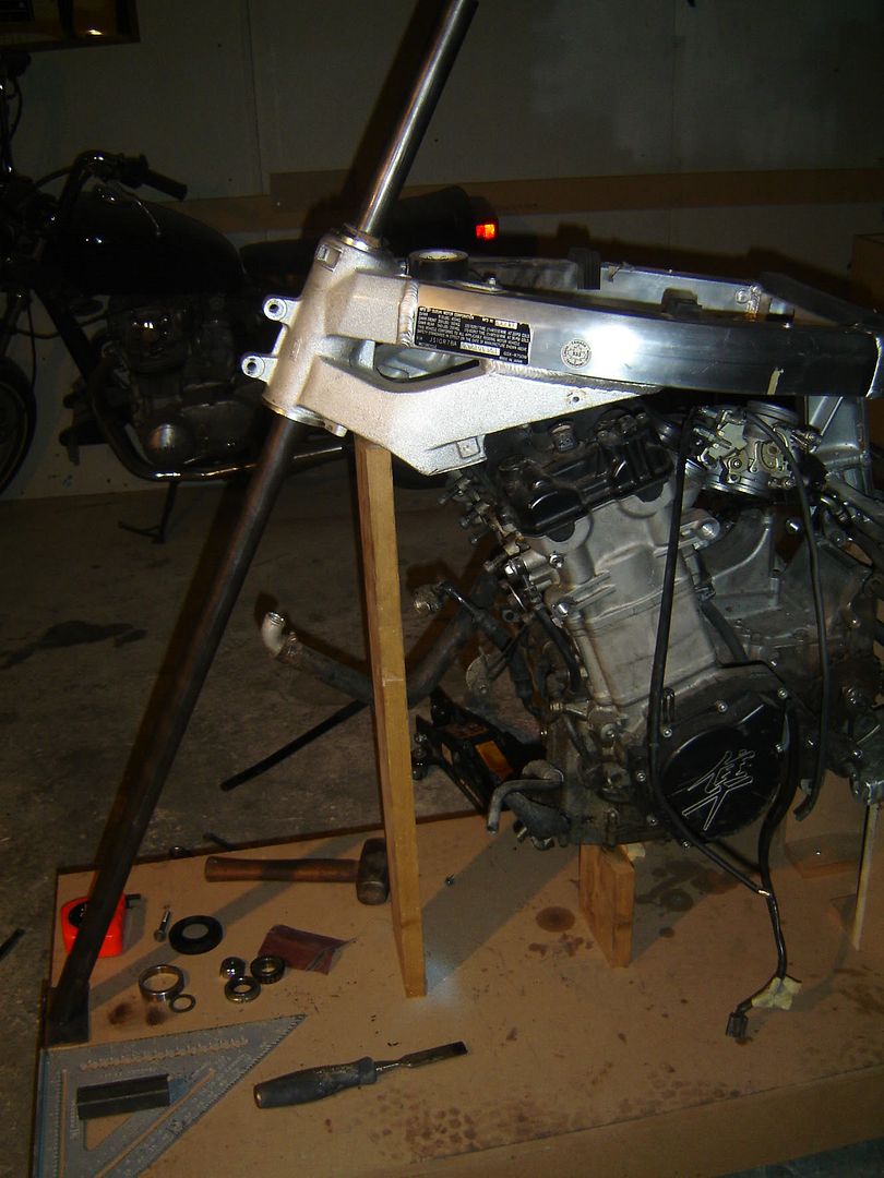

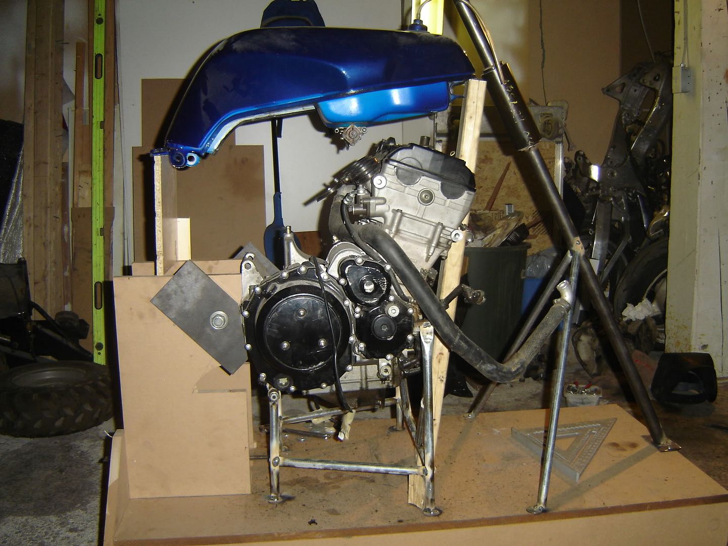

Traced my rake and all the key points from old frame. Its idiot proof.
