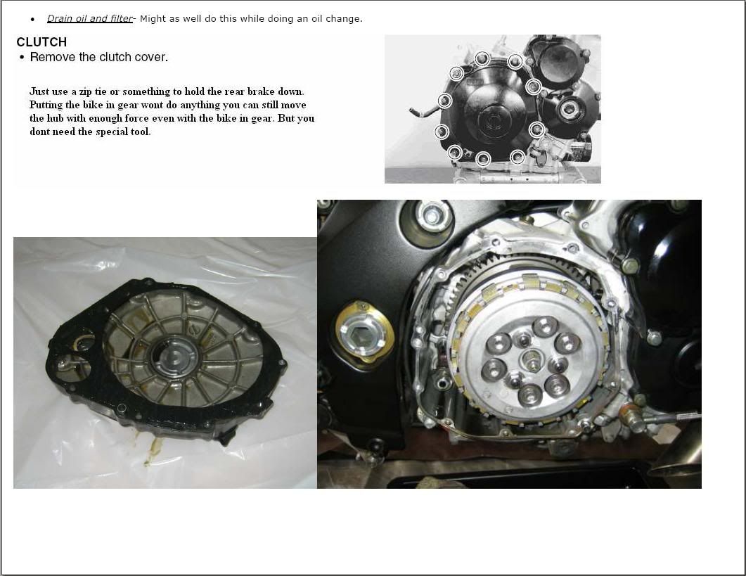

Here is my DIY contribution this great site. This is the clutch mod that has been discussed in the past. Thanks to Stocky for his contributions and others.
I have the PDF also for anyone interested to download here is the link Below. 56k users this is your best OPTION. Also if it expires pm me with your email and i will send it out.
http://www.savefile.com/files/636359
Enjoy!

I'm not sure if I'm the only person who experienced this, but you might want to add that the clutch will be super grabby after reinstallation, especially if you oil the plates well. Mine felt like it wouldn't even disengage, meaning the bike would lurch forward with the clutch all the way pulled in, when put in gear. One quick ride made it smooth as butter and perfect disengagement, but it might catch somebody and cause them to drop the bike in the driveway.
Awesome writeup, by the way.

K5 owners should also check they have 3 reaction springs.
Some of them came out with only 2 and the clutch slips a little too easy on deceleration.

Larsen - you may be right but i didnt experience this and it may be b/c i left the oil sitting in the bike for a day before i started it up but thanks for the heads up...
njfinests - this isnt something the dealer will fix under warranty, its a mod we do to improve the bike... if you like the way your clutch feels more power to you but since you said it yourself there is downtime b/c of the weather you might as well do it...
Stocky - thanks but none of this would have been possible if people like yourself don't take the time to disect things and try to improve them and i noticed mine had 3 reaction springs but your right it should be noted some come with 2.
Wayne - its pretty easy to do the hardest part is just getting rid of all the shavings. good luck
I must agree. I have no doubt I didn't do as good a job as Ali, but my clutch reacted the same way. It took me a while to figure out I needed to ride it, and get some oil in the plates.

This is something that has been discussed in the past and some people have not felt anything was wrong with their clutch so you may be one of those people who is satisfied and has not noticed any chatter which is fine but for the people like goebeld and others this will fix the issue. If you do a search on the clutch mod you will see many threads on this issue but since its such a cheap mod to do its worth doing if you changing the oil anyway
