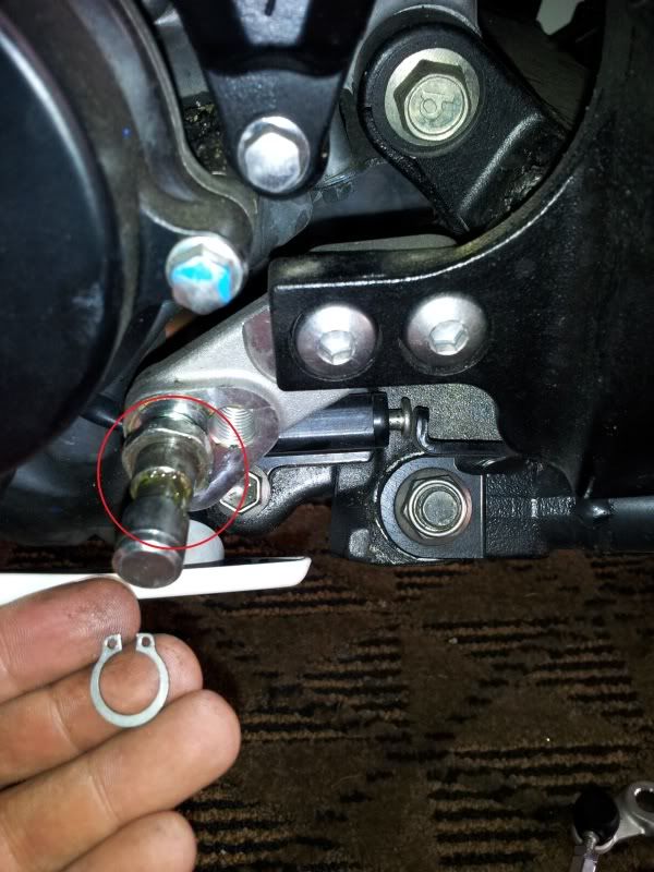

First loosen the nut circled and disconnect the rod.
Then take off the clip and the shifting mechanism should come off.

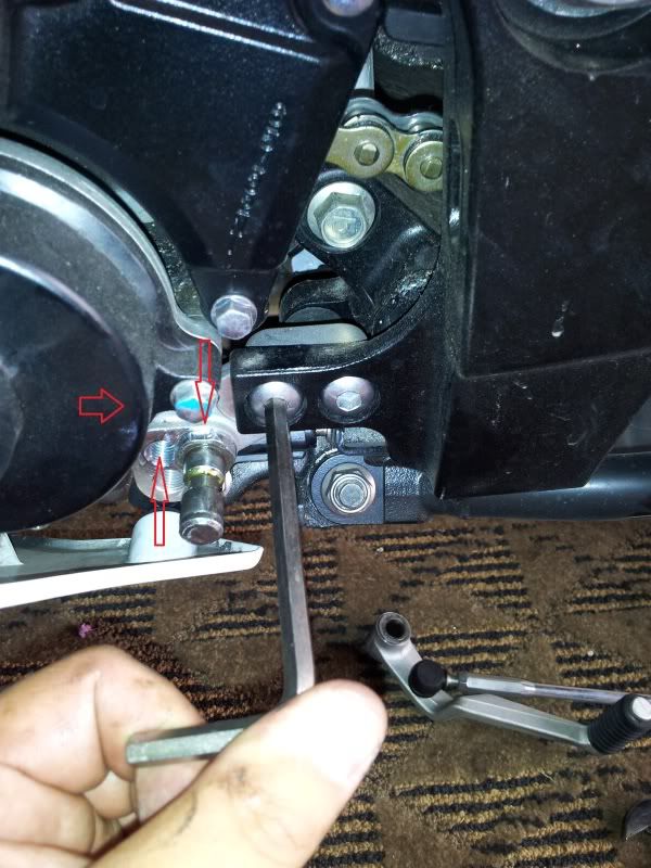

Now if you have the right tools just loosen the nut circled.
Then move it to the next hole on the right.
I did not have the right tools so I had to take the bracket off.

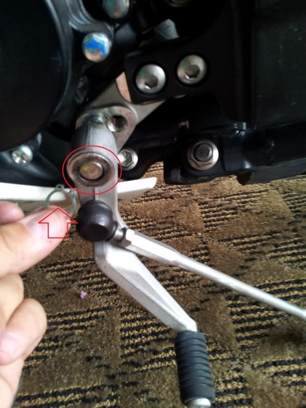

now just put the shifting mechanism back and make sure you put the clip back also.

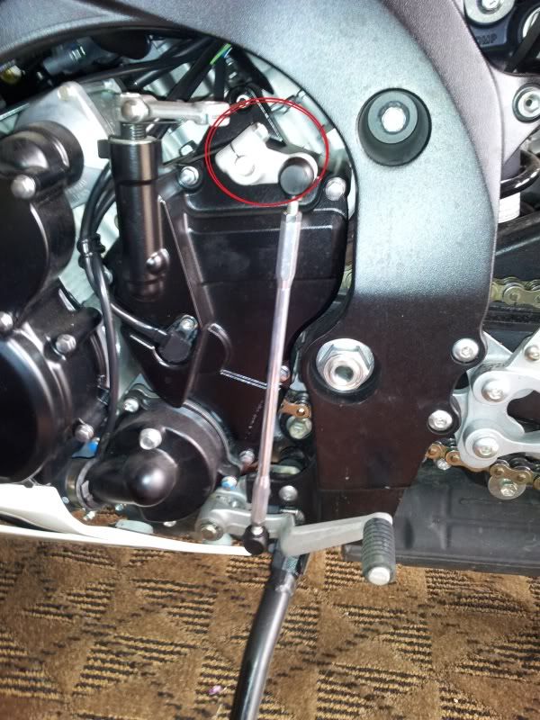

And Now the most important part. Put the circled part like this! (180 degrees from the original)
here is the original again
